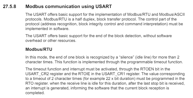

void startRxDma(void)
    // set timeout on idle
    MODIFY_REG(huart2.Instance->RTOR, USART_RTOR_RTO, MODBUS_TIMEOUT_IN_BITS);
    // enable timeout IT
    SET_BIT(huart2.Instance->CR2, USART_CR2_RTOEN);
    HAL_UART_Receive_DMA(&huart2, RS485Master.RX, UART_RX_BUF_SIZE);

	 // UART in mode Receiver on DMA : receiver timeout
	if (((isrflags & USART_ISR_RTOF) != 0U)
		&& ((cr2its & USART_CR2_RTOEN) != 0U))
		// WARNING do not use HAL_UART_DMAStop(), as it stops ALL DMA streams on this UART (= Rx AND Tx)
		// stop Rx DMA transfer
		__HAL_DMA_DISABLE(huart->hdmarx);
		// clear RTOEN  bit to avoid phantom timeout its
		CLEAR_BIT(huart->Instance->CR2, USART_CR2_RTOEN);
		// clear RTOF flag to acknowledge receiver timeout it
		__HAL_UART_CLEAR_FLAG(huart, UART_CLEAR_RTOF);
		// DMA IT will fire when transfer is complete

Modbus is a master/slave protocol, where slaves can "speak" only when master is sending them a question, so I am expecting only a packet from my slave (no continuous streaming). Moreover, reception and transmission cannot be done simultaneously, as my hardware is half duplex, ie transmission and reception are done on the same line. So I enable reception only after the end of transmission of a packet.
Which callback are you talking about? There are so many...
Received packets are supposed to be transfered to Rx buffer (RS485Master.RX) thanks to DMA as soon as they arrive in UART's reception register, and I do not need circular buffer mode, as I am only expecting one frame per reception, as stated in my DMA's initialisation function (please look at my first post).
UART will fire a receiver timeout interrupt when an idle state of 24 bits length (value of MODBUS_TIMEOUT_IN_BITS) is detected on the line after the reception of the last character. My HAL_UART_IRQHandler will handle it:

As explained in STM32F7's reference manual, DMA transfer may continue after a software disabling of the stream. The software shall wait that DMA's transfer complete interrupt fires before reading data, to ensure that all of them have been successfully transfered (sorry, I did not tell that in my first post). Here is my DMA transfer complete handler:

With
void HAL_UART_RxCpltCallback(UART_HandleTypeDef *huart)
// reception on DMA
    if((huart->Instance == USART2) && (1 == dmaTransferComplete))
    	// also disable DMA error flags
    	huart->hdmarx->Instance->CR  &= ~( DMA_IT_TE | DMA_IT_DME);
    	huart->hdmarx->Instance->FCR &= ~(DMA_IT_FE);
    	frameReceived = 1;
    	// get nr of bytes got during this transfer
    	remainingBytesToTransfer = __HAL_DMA_GET_COUNTER(huart->hdmarx);
    	dmaTransferComplete = 0;
frameReceived is declared as volatile too.
My modbus state machine is watching frameReceived:

But at reception of 3rd frame, the value stored in remainingBytesToTransfer is not the same as the one in DMA's NDTR register, although the frame in Rx buffer is correct... :thinking_face: I wonder how this can happen...
You're doing more work than needed. Use HAL_UARTEx_ReceiveToIdle_DMA and  HAL_UARTEx_RxEventCallback instead.
See this project for better understanding how to use HAL_UARTEx_ReceiveToIdle_DMA to your advantage
https://github.com/karlyamashita/Nucleo-G431RB_Three_UART/wiki
In your case you don't need a ring buffer as the receive buffer won't get overwritten until you transmit another message to the slave.
If a reply has proven helpful, click on Accept as Solution so that it'll show at top of the post.
CAN Jammer an open source CAN bus hacking tool
CANableV3 Open Source
ABous.3
Associate III
Hi Karl,
I updated my HAL & CMSIS drivers to be able to use the functions you adviced, and now it works perfectly! Thak you for your help.
Regards,
Agnes
