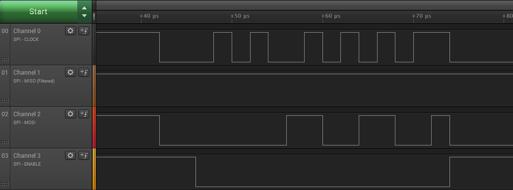

I have been trying to perform SPI communication and observe outgoing and incoming data through MOSI & MISO. There is a weird problem in SCK weveform
There are the codes I wrote :

2018-10-07 8:24 AM
Too low sampling rate of the logic analyzer?
2018-10-07 8:43 AM
Oh ! Never came to my mind. I was puzzling my brain on it :) It works thanks a lot !
