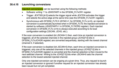

Hello @MannyMarc35
@MannyMarc35 wrote:
What is the best approach to sample two channels using a single DFSDM filter?
The best approach is to use the injected conversion with scan conversion enabled.
2025-08-02 2:20 AM
Hi @Saket_Om ,
thanks for your reply.
I understand that both channels can be configured by using regular and injected conversion and triggered sequentially using one trigger event. However, I have a few open questions before proceeding:
Which trigger is most suitable for injected conversions in this setup?
I see options like TIM1_TRGO, but I'm unsure whether that's the best choice or if I should use software trigger (trigger from regular conversion)
Is DMA supported for injected scan conversions?
If yes, does it automatically copy both values (one per channel) into the buffer? Or would I need to manage the transfers manually (e.g. by reading via HAL_DFSDM_FilterGetInjectedValue() in the callback)?
Do I need a separate DMA stream for injected conversions?
Currently, regular conversion uses DMA1_Stream0. Can injected use the same stream, or must I set up an additional DMA handle?
What’s the best way to synchronize the trigger and buffer handling?
For regular conversions, the DMA transfer completes when the buffer is full. With injected conversions triggered periodically (e.g. by a timer), how should I design the timing so I don’t miss data or cause overlaps?
Of course, some kind of example would be best, but I appreciate any help. Thanks in advance.

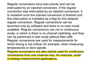

2025-08-04 3:27 AM
Hello @MannyMarc35
For audio applications, it is recommended to use the regular mode, which is typically used for continuous conversions from a single channel.
Please refer to the document below for more details:
In your application, you need to configure 8 channels and 8 filters and then synchronize all the filters with filter 0. This allows all conversions to start simultaneously.
To use DMA, you also need to configure 8 DMA streams, one for each filter.
Please refer to the example project: Projects/STM32H743I-EVAL/Examples/DFSDM/DFSDM_AudioRecord,
which demonstrates the use of 2 DFSDM channels, 2 filters, and 2 DMA streams. To add an additional DFSDM channel, you need to configure it in the same way as filter 1 in the example.

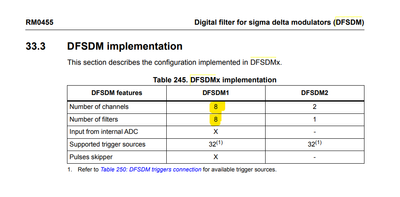

2025-08-04 5:28 AM - edited 2025-08-04 5:28 AM
Hello @Saket_Om ,
So, is it not possible or recommended to use a filter for two channels (regular + injected conversion)?
My problem is that the STM32H743ZIT6 only offers four filters and eight channels. Therefore, I wanted to use a filter for two channels.
2025-08-04 6:14 AM
Hello @MannyMarc35
For audio application, usage of regular channel is recommended to guaranty the audio quality with continuous conversions (usage of timer or external trigger to launch injected conversions at specific time is very not easy to implement and not recommended).
You need also to synchronize all your channels to guaranty audio samples synchronized (regular conversions are recommended because injected conversions on one filter are performed one after the other so not synchronously).
Unfortunately, with only 4 filters, we recommend performing an audio record with only 4 digital microphones. If you require more filters, consider using the STM32H7A3/7B3 or STM32H7B0 series, which feature DFSDM with 8 channels and 8 filters.
