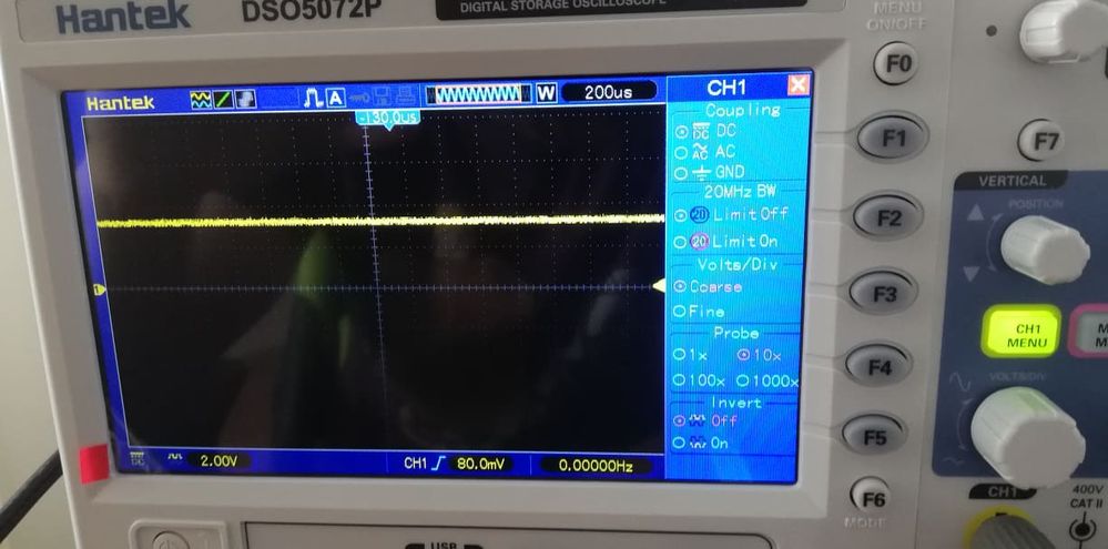

Now after reading some stuff about oscilloscopes I have one more question:
I have attached a photo with the channel 0 when 'Dc coupling' is selected and also all the settings are shown there on the right:

DC coupling is OK, but even with AC you should've seen something else than just noise. You should adjust the timebase to ca 100ns but again, even with 200us as you have it now you should see something.
So the MCO1 is not working, or the mcu is not running at all.
Try to write a simple program which sets a pin as GPIO Output and toggles it in a loop.
