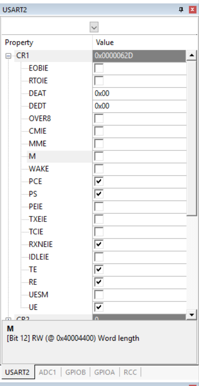

So I "fixed" it.

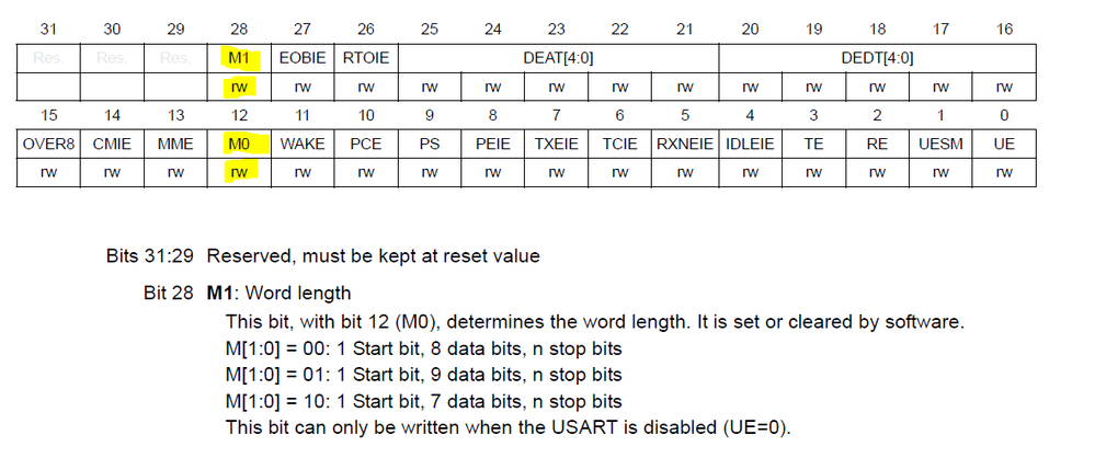

I set the data bits on the PC side to 7 bits and it works. However my STM is clearly set to 8 bits as shown below.
The datasheet clearly shows that bits 28 and 12, M1 and M0 respectively, set the word length. So when they are set to 00 the data bits are 8 bits.
So I debugged the code and check it. Below it shows clearly that the register value indicates that both of them are 0. However as shown in the debugger view while the register value reflects this, there is only one "M" bit set and it is bit 12. Bit 28 is not show there at all. So basically in 7 bit mode it works flawlessly however in 8 bit mode it doesn't work at all despite the reference manual saying otherwise.
Can anyone shed some light on this?

So I "fixed" it.
