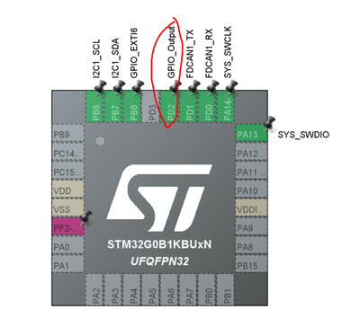

Not sure what is going on, im unable to toggle an IO and im not sure why...
This is a very simply custom board, it uses I2C, CAN and USB. I've configured everything in CubeMX and double checked the pinout and gerber files several times but i can't find anything wrong. I've double checked the voltages on VDD and VDDIO2, both are 3.3V.
I've tried configuring PD2 as Push-Pull and Open drain with and without pull-up but i get no change on the pin when measuring with my scope.
PD2 is connected to the CAN STBY pin that has an internal pull-up, the pin remains high when the PHY is connected and low when the PHY is disconnected. This would indicate that there is no short on the board and that the electrical part is fine.
I have physically probed the connections on the board and they are correct.
What am i missing, do i need to configure something else?
Below is the minimum CubeMX project. I2C and the EXTI work fine but PD2 does not.

Hi @Ghofrane GSOURI ,
I have attached the CubeMX file, i can provide the entire CubeIDE project if needed. But It's simply the HAL toggle code in the main loop.

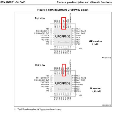

Are you sure the part number is correct? Try toggling PB4, which is in the same pin position on similar chips.

Either this:
i.e. you in fact have the non-N-suffixed part,
or you don't have properly connected VDDIO2 pin.
or something else, in which case read out and check/post content of GPIOD registers.

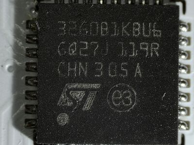

2026-02-03 11:31 PM
Hi @TDK & @waclawek.jan,
I made sure to triple check the BOM and the other manufacturer files i sent to the fab. I had specified the N-variant, se below.
Checking the IC marking shows that it is in fact not the N variant. Could anybody confirm this before I involve the fab?
First time i've got a similar processor but not the one i specified in the BOM, got to be the first for everything....
2026-02-04 2:53 AM
So just try: set the pin D2 to -> B4 , GPIOB , pin 4 . Check...toggle.

2026-02-04 3:54 AM
PB4 toggles the PD2 pin.
It seems that the fab placed the non N-variant...
