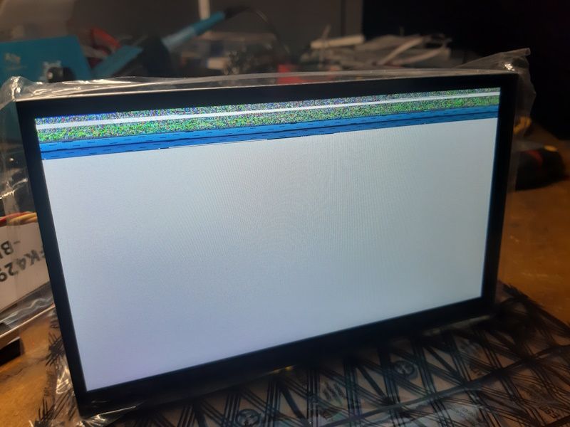

2024-04-24 7:59 AM
Ok, need to understand the hanging. Check the Hard Faulting situation.
Blue / Black doesn't make a lot of sense.
Try pointing the LTDC Frame Buffer at the 0x08000000 FLASH address, should see more colourful data reflective of the opcodes in the firmware, and perhaps white when it gets to the 0xFFFFFFFF patterns.
Trying to establish if the issue is with the memory transfer, or the timings, or something else
The minimum frequency in the screen spec is 26.4 MHz
2024-04-24 11:21 AM
if (HAL_LTDC_Init(&hltdc) != HAL_OK)
Error_Handler();
pLayerCfg.WindowX0 = 0;
pLayerCfg.WindowX1 = 799;
pLayerCfg.WindowY0 = 0;
pLayerCfg.WindowY1 = 479;
pLayerCfg.PixelFormat = LTDC_PIXEL_FORMAT_ARGB8888;
pLayerCfg.Alpha = 255;
pLayerCfg.Alpha0 = 0;
pLayerCfg.BlendingFactor1 = LTDC_BLENDING_FACTOR1_CA;
pLayerCfg.BlendingFactor2 = LTDC_BLENDING_FACTOR2_CA;
pLayerCfg.FBStartAdress = 0x08000000 ; // x 0xD0000000
pLayerCfg.ImageWidth = 800;
pLayerCfg.ImageHeight = 480;
pLayerCfg.Backcolor.Blue = 0;
pLayerCfg.Backcolor.Green = 0;
pLayerCfg.Backcolor.Red = 0;
