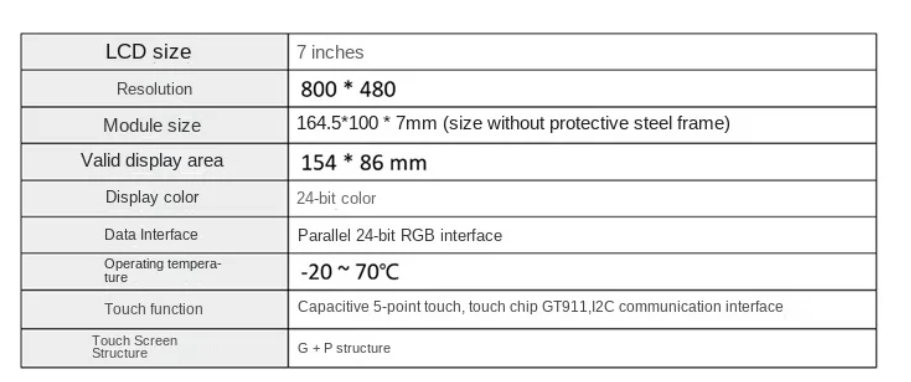

I am starting some test with this module
https://it.aliexpress.com/item/1005002482177244.html
with 7” lcd
I have found only one example that run but with Touchgfx
I have got the same ioc from this example to generate a new code and insert the functions to switch on lcd but still no result
I would like to use the normal functions
BSP_LCD_Init() ;
BSP_LCD_DisplayStringAt(10, 80, buf, LEFT_MODE);
BSP_LCD_DrawBitmap(0, 0, (uint8_t *)(&BackGround0));

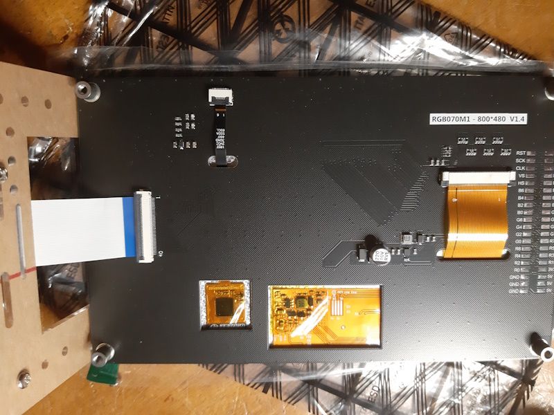

#define VFP 2 // FRONT PORCHOk so a FANKE RGB070M1 800x480 V1.4 with AT070TN92 panel
https://www.beyondinfinite.com/lcd/Library/Innolux/AT070TN92.pdf

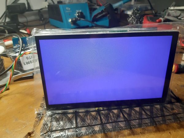

2024-04-23 10:06 PM
Tesla DeLorean, Your set not RUN
This RUN and show a blue screen
PeriphClkInitStruct.PLLSAI.PLLSAIN = 60;
PeriphClkInitStruct.PLLSAI.PLLSAIR = 2;
PeriphClkInitStruct.PLLSAIDivR = RCC_PLLSAIDIVR_2;
#define HBP 80
#define VBP 40
#define HSW 1
#define VSW 1
#define HFP 190
#define VFP 22
#define LCD_Width 800
#define LCD_Height 480
#define LCD_Pixels 800*480
#define LCD_MemoryAdd 0xD0000000
hltdc.Init.HorizontalSync = HSW - 1;
hltdc.Init.VerticalSync = VSW -1 ;
hltdc.Init.AccumulatedHBP = HBP + HSW -1;
hltdc.Init.AccumulatedVBP = VBP + VSW -1;
hltdc.Init.AccumulatedActiveW = LCD_Width + HSW + HBP -1;
hltdc.Init.AccumulatedActiveH = LCD_Height + VSW + VBP -1;
hltdc.Init.TotalWidth = LCD_Width + HSW + HBP + HFP - 1;
hltdc.Init.TotalHeigh = LCD_Height + VSW + VBP + VFP - 1;
| run | ||||
| HBP | 80 | AccumulatedHBP | 40 | |
| VBP | 40 | AccumulatedVBP | 40 | |
| HSW | 1 | HorizontalSync | 0 | |
| VSW | 1 | VerticalSync | 0 | |
| HFP | 190 | AccumulatedActiveW | 880 | |
| VFP | 22 | AccumulatedActiveH | 520 | |
| LCD_Width | 800 | TotalWidth | 1071 | |
| LCD_Height | 480 | TotalHeigh | 543 |
