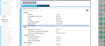

2) transfer the screen pixel data to MCU from touchGFX; (How to get the partial pixel data in certain areas?)
You can get the framebuffer data by checking where you store the framebuffer.
Open your STM32CubeMX file (in your project folder, open the .ioc file), check "middleware", then "TouchGFX" and here you can see where your framebuffer is stored :
Your framebuffer size id width*height*RGBprecision. Here is another example of that : memory-consumption .
Now that you have the framebuffer location and size, you need to only fetch the data of the canvas (or alternatively you could isolate the drawing by saving the minX, minY, maxX and maxY and adding a bit of padding) and store it into whatever format you want (an array, a jpeg, a png, a bmp).

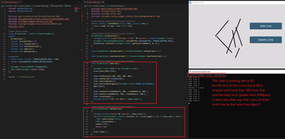

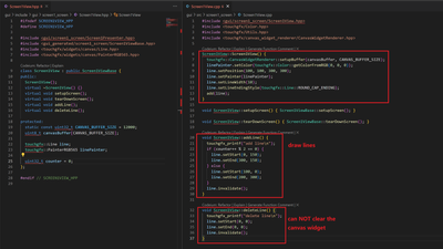

2024-06-16 6:06 AM - edited 2024-06-16 6:58 AM
2024-06-16 6:12 AM - edited 2024-06-16 6:57 AM
2024-06-16 7:13 AM - edited 2024-06-16 7:14 AM

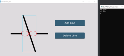

I am trying the canvas widget, it seems to work, but still some issues:
The code above is trying to draw an "X", but the second line overwrites some area of the first line, as below:
And the delete button can NOT clear the canvas area, how to do it?
Thank you!
(The project is uploaded as Attachment.)

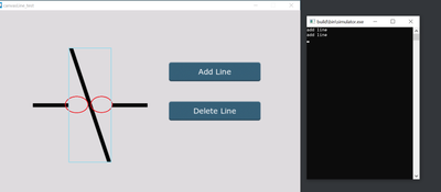

2024-06-17 2:42 AM
Hi @MM..1
According to your help, I can add and delete the line dynamically.
The code and the phenomenon as below:
As the result in above picture, it is work well, but need to much heap.
In my last version(picture below):
I set the color of line painter to RGB565, is any possible to change the painter color to ARGB2222 to resolve the overwrite problem(may the alpha value can control the overwrite area)?
I want to try, but don't know how to change the color format, it should be similar with following code:
touchgfx::PainterARGB2222 linePainter;
linePainter.setColor(touchgfx::Color::getColorFromARGB(0, 0, 0, 0)); // compiler errThanks very much!
