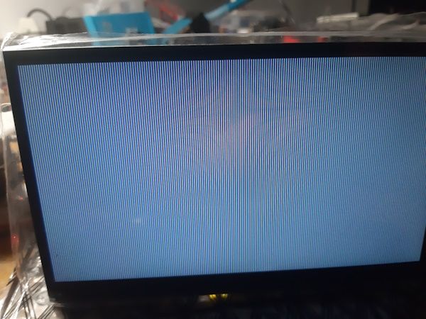

2024-04-23 1:31 PM - edited 2024-04-23 1:43 PM
new ver with strange vertical line
www.audiodesignguide.com/sw1/stm32F429BI-test2%20%282%29.zip
hltdc.Instance = LTDC;
hltdc.Init.HSPolarity = LTDC_HSPOLARITY_AL;
hltdc.Init.VSPolarity = LTDC_VSPOLARITY_AL;
hltdc.Init.DEPolarity = LTDC_DEPOLARITY_AL;
hltdc.Init.PCPolarity = LTDC_PCPOLARITY_IPC;
hltdc.Init.HorizontalSync = 1; ?
hltdc.Init.VerticalSync = 1; ?
hltdc.Init.AccumulatedHBP = 76; ?
hltdc.Init.AccumulatedVBP = 40; -> see vertical line and with 23 no output
hltdc.Init.AccumulatedActiveW = 880; ?
hltdc.Init.AccumulatedActiveH = 520; ?
hltdc.Init.TotalWidth = 1080; ?
hltdc.Init.TotalHeigh = 542; ?

2024-04-23 1:50 PM
This is an up-hill struggle.
What's the Make/Model of Screen?
What's the Resolution of the Screen?
Can you provide a picture of the back showing the controller or part#, large, clear and in-focus.
Is there a Data Sheet for the Screen?
Line totals are a combination of sync, front and back porches, and the active portion (ie visible pixels), count's in pixels. Think Preamble, Content, Postamble
