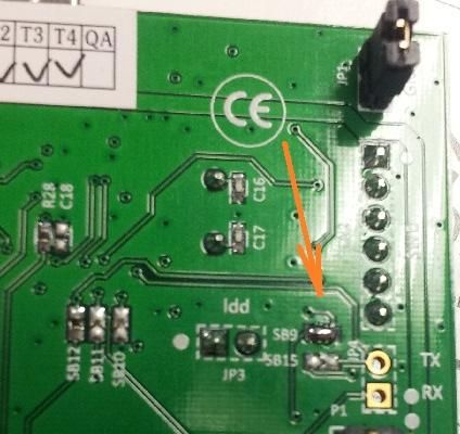

Two key points:
On STM32 DISCO boards you need to make sure any SB (Solder Bridges) require to make the PB3 (SWO) connection to the ST-LINK. On the STM32F429I-DISCO you must make SB9. The frequency setting for the trace must be the speed you are running the core/pll, ie 168 MHz or 180 MHz, or whatever you have set in system_stm32f4xx.c2014-05-21 5:21 AM

Yes, I have the STM32F429I-DISCO working with the Serial Wire Viewer (SWV). I'm also pretty sure why it's not working for you.2014-05-21 6:38 AM
Thanks for the reply :) the pb3 to swd connection solved the problem and it works :)

You are welcome, I saw you had success, but posted the graphic for others who might stumble upon this thread in the future. Some of the DISCO and NUCLEO boards have the connection made, others don't.2014-05-21 7:35 AM
i see it, thanks :) i connected the pb3 to the swd port's first pin
