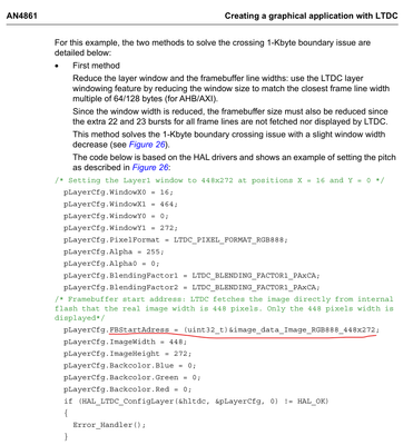

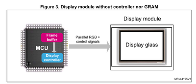

According to ST’s Application Note AN4861, I am using the internal frame buffer to send parallel RGB signals along with synchronization signals to the LCD. The total image size is:

However, the standard LTDC configuration in STM32Cube sets FBStartAddress to point to a full-frame buffer (854 x 480 x 24-bit). This results in a lot of redundant memory usage.
