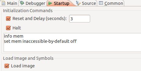

I have been using a quick and dirty solution to view the external memory in my gdb debugger now. Those who compile and debug their STM32F4 MCU in Linux Eclipse based gcc environment, can follow the steps below:
- In Eclipse IDE open Debug Configurations under Run menu.- Select your debugging configuration under ''GDB Hardware Debugging''- Select Startup configuration on the right pane and enter the following commands :info memset mem inaccessible-by-default off- Save your changes and now you can access to those memory spaces which the target doesn't define them explicitly for the gdb.. The first line (info mem) prints out the mem view of the gdb at the start of the debug session (output in the gdb console).118,926 (gdb)
118,926 14info mem118,926 &''info mem\n''118,926 ~''Using memory regions provided by the target.\n''118,926 ~''Num Enb Low Addr High Addr Attrs \n''118,926 ~''0 y \t0x00000000 0x00200000 ro nocache \n''118,926 ~''1 y \t0x08000000 0x08200000 flash blocksize 0x4000 nocache \n''118,926 ~''2 y \t0x1fff0000 0x1fff7800 ro nocache \n''118,926 ~''3 y \t0x1ffff800 0x1ffff810 ro nocache \n''118,926 ~''4 y \t0x20000000 0x20030000 rw nocache \n''118,926 ~''5 y \t0x40000000 0x5fffffff rw nocache \n''118,926 ~''6 y \t0xe0000000 0xffffffff rw nocache \n''118,926 14^done118,926 (gdb) 118,927 15set mem inaccessible-by-default off118,929 &''set mem inaccessible-by-default off\n''118,929 =cmd-param-changed,param=''mem inaccessible-by-default'',value=''off''118,930 15^doneWe’re moving the ST Community to a new platform to give you a better and more reliable community experience.
