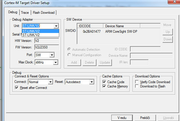

If you have multiple instances of STLink connected to PC, then you can select which will be connected where in your Keil projects.
Keil allows you to select STLink Serial number (picture below).Now, you can detach all stlinks, connect first and set it for your project, then remove first and insert another and set for another project.I've tested this using F429-Disco and F401-Nucleo, works great.Another way to get all connected STLinks is to open ST-Link Utility and under ''Target'' -> ''Settings...'' you have available STLinks probes.2015-01-07 4:41 PM

I'm using a couple of Nucleo-F072RB and the Debug Target Driver for the onboard ST-LINK/V2 reports Ser. Number ''N/A''. HW Version is ''V2'' as in your picture, Firmware Version is ''V2J23S6''.
