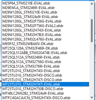

Because you are using STM32H757I-EVAL board (Eval board) and you set the incorrect flash loader MT25TL01G_STM32H747I-DISCO.stldr (used for Disco board).
You need to use MT25TL01G_STM32H747-EVAL.stldr (I think it's compatible with STM32H757I-EVAL board with the same hardware configuration) :
Hope that helps.
