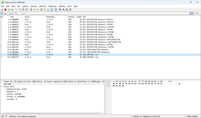

For a first time i am trying to implement usb vendor device. I am using stm32 standard peripheral library. Basically CDC class, having modified the interface recognition part. Can i have some direction what i am missing to implement. Here are some debug logs.

I think this part is ok but still device does not want to speak with me. I used Wireshard to listen communication with PC and after this steps there is only one request step.
Req 1, with value 0x300- i send this and recive status ok.(i dont know what is that request, just send it because i see it on Wireshark listener). After i send request i am trying to send bulk packet and recive answer but nothing comes in. Here is my Init interface function and state machine for send/receive.
