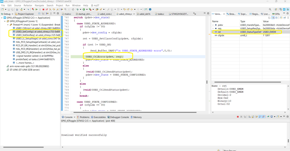

As per reference document added USB driver in firmware , but gives error at function
USBD_SetClassConfig(pdev, cfgidx);
added screenshot of error
If ignore this error , USB Serial device port detected but failed to set transmission buffer

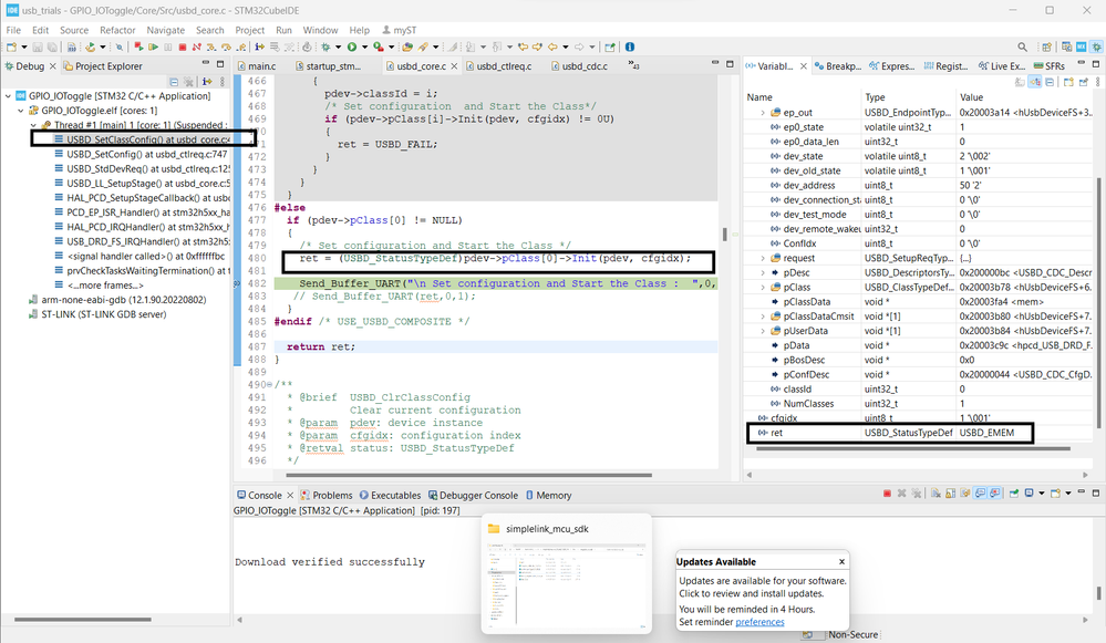

2023-12-03 6:20 AM
Go into USBD_SetClassConfig and figure out why it's failing. Set a breakpoint, step through.

Hello ,
USBD_EMEM error received in USBD_SetClassConfig
2023-12-04 5:57 AM
Keep following it. Go into the Init function and find where that failed...

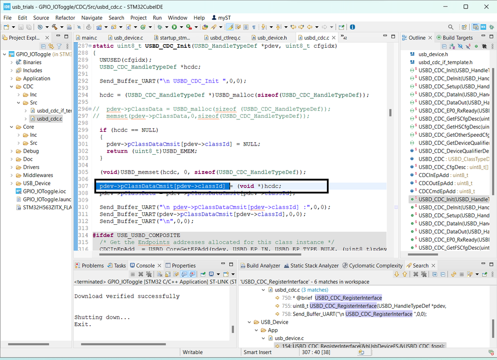

it will fail in CDC_INIT function
pdev->pClassDataCmsit[pdev->classId] always return a NULL value

2023-12-05 6:22 AM
Step through USBD_malloc and understand why it's failing. On newer HAL USB versions, this is a static allocation which can never fail. On older ones it called malloc, which should work, but may not if you have insufficient heap space.
USBD_EMEM indicates a memory error.
