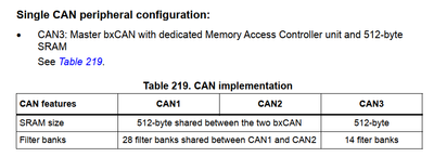

Pages 1076-1077 of the part datasheet/reference manual (RM0430) lists dual and single CAN peripheral configurations:
First question: is it possible to run all three CAN interfaces simultaneously and receive messages from each of them?
CAN2 doesn't have direct access to SRAM, so I think if I want to use CAN2 for receiving, I also need to enable CAN1. Is that correct?
I don't understand what is meant by the master/slave relationship between CAN1 and CAN2. It sounds like messages received on CAN2 need to "route" through CAN1 to get to SRAM, but I'm not sure. How should CAN1 and CAN 2 be configured so that I can receive messages on either interface?
