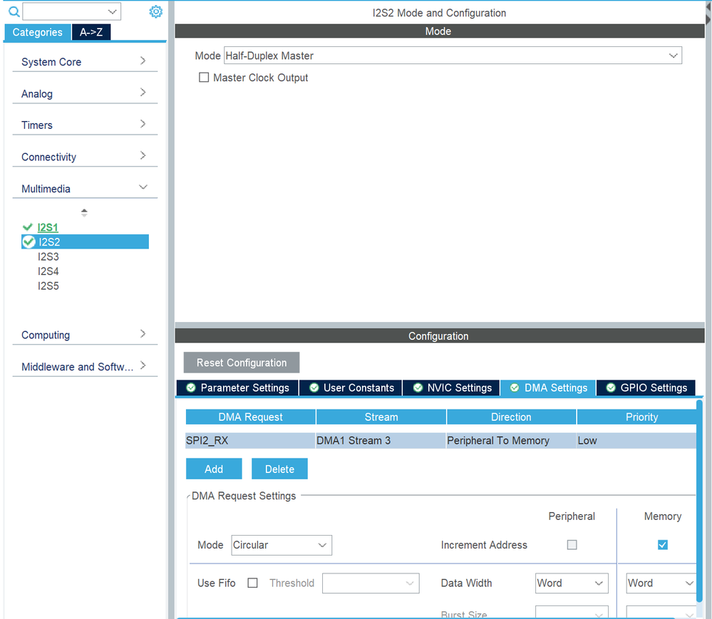

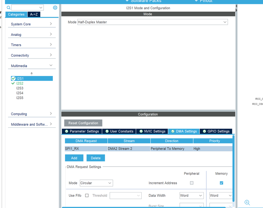

I2S1 RX → DMA2 Stream2
I2S2 RX → DMA1 Stream3
Both in circular mode
FIFO disabled
24-bit Philips I2S mode

This makes me suspect:
hidden DMA conflict?
wrong memory alignment?
a silicon errata related to STM32F4 DMA + I2S?
some CubeMX-generated initialization order bug?
I’ve been debugging this for a week and still cannot find the root cause.
Has anyone experienced cross-talk between two DMA streams on STM32F4 when using dual I2S master RX?
Any guidance or similar cases would be appreciated.
