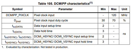

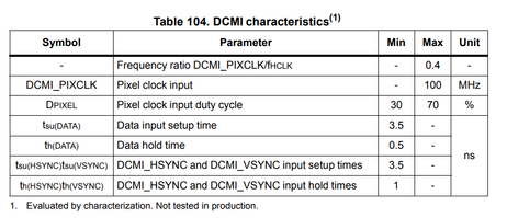

The maximum DCMI pixel clock = 100 MHz and the maximum DCMIPP pixel clock is 120 MHz as mentioned in the datasheet Table 104 and Table 105.
