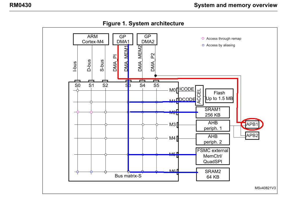

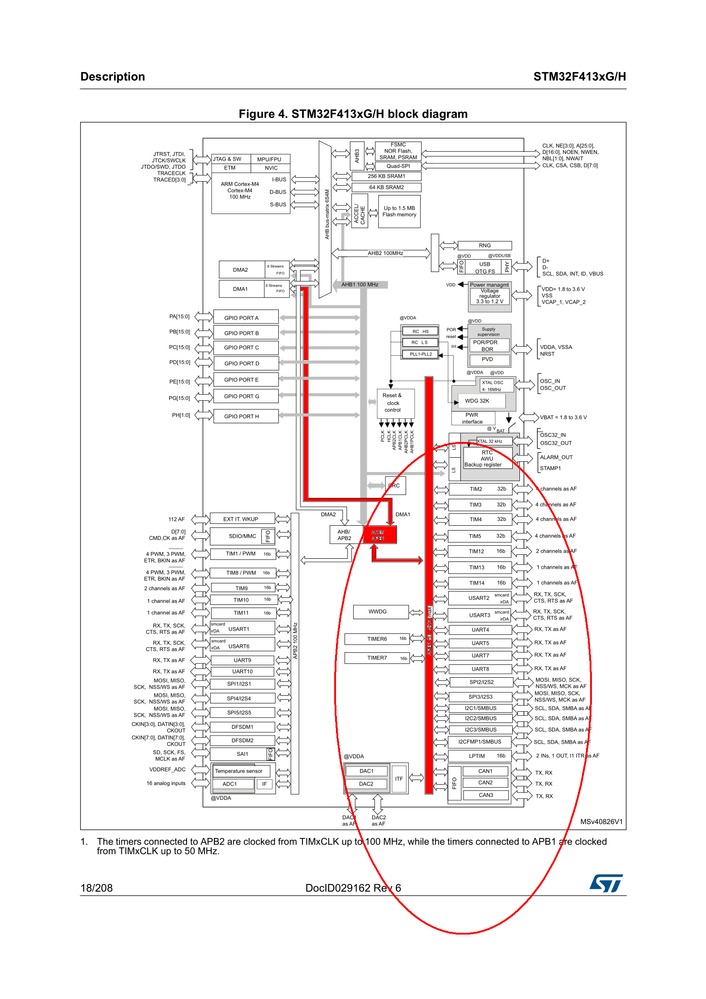

Oh, of course not. This is the picture you are looking for:
and this one:
(There's also Tab.1 in RM, but that's way less sexy).
However, except for timer, I don't recommend you to use any other peripheral-port target than the data register of the peripheral which triggers that stream. And note, that on the memory port you can't access peripherals (not even APB1 peripherals), only memories. So, for most practical purposes, the table given by md.suhel is adequate.

2019-01-18 11:17 AM
and this one:

2019-01-18 12:21 PM
Thanks @Community member - I saw that but I've confused about the nomenclature. In the datasheet there's a memory table that shows the following. AHB1 vs. APB1? What I'm missing is which peripherals are associated with APB1? Aha! Thanks @Community member for pointing me to the diagram and table.
Appreciate the help!
2019-01-18 12:28 PM
And I now see why my DMA failed. I'll need to rework the puzzle to get a trigger into some DMA2 stream (perhaps by chaining timers)... Thanks Guys!
2019-01-18 12:53 PM
Those in the red circle in that second picture I posted above.
And, as I've said there, in Tab1 in RM they are listed, with APB1 in the column next to them. (those which have AHB1 in that column, belong to... ehm... AHB1; similar with other buses).

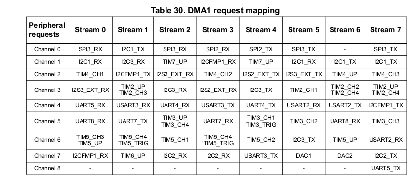

On this note there is an error in Table 30. DMA1 Request Mapping:
Channel 5 Stream 0, should be UART8_TX (Not Rx)
