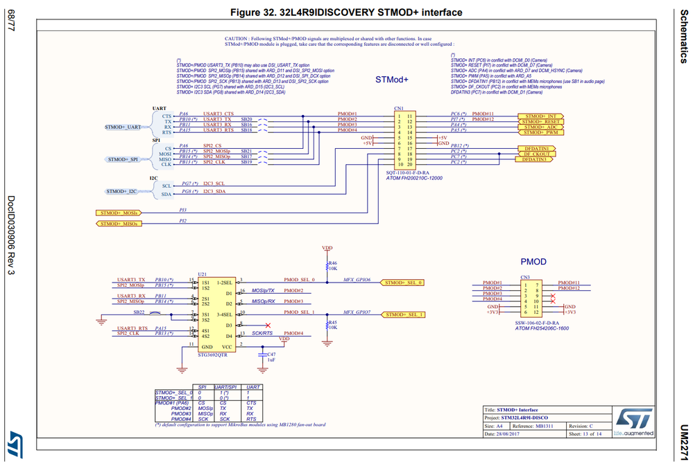

As per the specification doc,configured the Quad SPDT switch configuration,to use the SPI pins in PMOD connection.
quad SPDT switch conf:
But still the spi interface issue is existing .
So request your help in solving the issue.
Note:Below are the PMOD spi pins which i was trying to use after configuring the Quad SPDT switch .
1 SPI2_CS/USART3_CTS (PA6)
2 SPI2_MOSIp/USART3_TXD (PB15/PB10)
3 SPI2_MISOp/USART3_RXD (PB14/PB11)
4 SPI2_SCK/USART3_RTS (PB13/PA15)

"We are working with STM32L4R9 Discovery board. When trying to use SPI2 on PMOD we observed that, by default SPI MOSI and MISO pins are configured to USART3_TXD and USART3_RXD respectively.
As per the user manual (UM2271 User manual - Discovery kit with STM32L4R9AI MCU - Page 39), to enable SPI2 on PMOD, it requires a change in MFX_V3 circuit configuration.
We are unable to find the steps required for configuring MFX_V3 circuit.
Could you please help us with sample code or any other steps to enable SPI2 on PMOD?"

2019-04-01 11:31 PM
Remove SB20,16,18 if you still need the USART for arduino, otherwise, put these pin as digital input (HiZ)
Solder short SB21,17,19 and you'll have SPI2 on STMod+ and PMOD connectors 1,2,3,4

2019-04-02 12:53 AM
Unfortunately, the discovery board MCU package doesn't have enough pins to make things easier.
I noticed that some other disco use MCU controlled digital mux to avoid soldering.

2019-04-03 12:25 AM
Hi Team,
By setting the pins GPIO6 and GPIO7 to 0 by using below code snippet we were able to use the spi pins in PMOD.
code snippet:
BSP_IO_WritePin(IO_PIN_6|IO_PIN_7, GPIO_PIN_RESET);
BSP_IO_ConfigPin(IO_PIN_6|IO_PIN_7 ,IO_MODE_OUTPUT);
could you please confirm whether we can proceed with the above configurations ?
