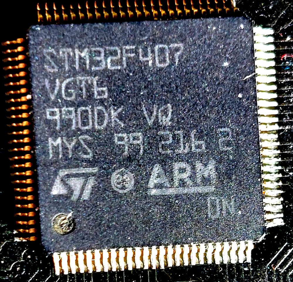

I have an issue with some STM32F407VG chips.
Values stored in flash are wrong, e.g.
Flash size at address 0x1FFF7A22 is 0xFFFF instead of 0x400.
Temperature sensor calibration data for 30°C is 0xFFFF.
Here after is a picture of the bad chip.
Thanks in advance for your help.

Welcome @zeboss49, to the community!
Recently, a great many STM32 have been counterfeited and are apparently still entering the market. The status can be clearly determined if you send me a clearly legible photo of the packaging label with the Bulk ID by personal message.
Please do not post the Bulk ID here because it can be misused for illegal purposes. I will answer directly via personal message.

2023-07-11 5:27 AM
I'm sorry, but I don't have the bulk ID.
The only information I have is what's engraved on the chip itself (see attachment).
Unfortunately, your answer is a confirmation of what I suspected, fake chips coming fromChina.
Thanks for the quick reply.

2023-07-12 5:48 AM
parts are soldered on PCB boards.
But I've noticed that all the parts share the same unique ID...
Very likely fake parts.
.Thanks for the answer.
