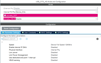

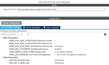

I configured the USB with the following parameters: (Clock to USB = 48MHz)
The USB is initialized fine and I can open the Port Com on my computer.
If I put data to the usb directly after the USB init it is working, but once I use another peripheral (UART, SPI…) the USB no longer outputs any data and the function CDC_Transmit_HS returns a busy error
