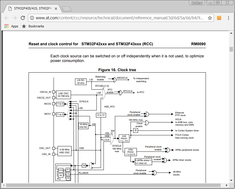

From the block diagram, either /2 or /20 is possible.
Which block diagram are you talking about?
And, once this is setup, can the HSE be treated as 25MHz in order to set the other parameters? I.e. PLL_N, PLL_Q, PLL_M, etc?
No, treat it simply as 50MHz... As far as PLL is concerned, the simplest way is to take the parameters you had for 25MHz and multiply the predivider (PLL_M) by two.
2018-03-21 8:56 AM
Surely, 6.21 from the Ref Manual (above) covers it?

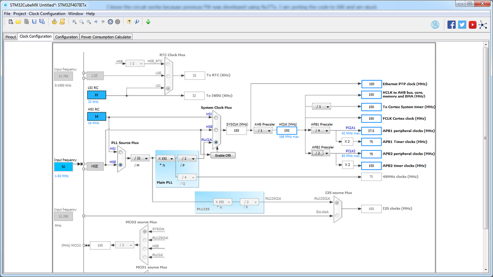

For some reason I don't see anyone mentioning the obvious - STMCube clock manager. You can set 50MHz and then tweak away at the internal dividers This is an example. It can produce the necessary clock setup code only if that's what you want.
