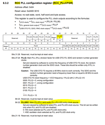

I want to understand "which register decides whether HSI or HSE oscillator is selected for PLL clock source in STM32F407"(selection of the HSI or HSE oscillator as PLL clock source"

According to the RM0090, the PLL source is selected throw the PLLSRC bit of the RCC_PLLCFGR register:
For your coming requests, please have a look at our documents, almost all details are well provided there as said @Andrew Neil .

2025-01-24 2:21 AM
Hello @Ash1
