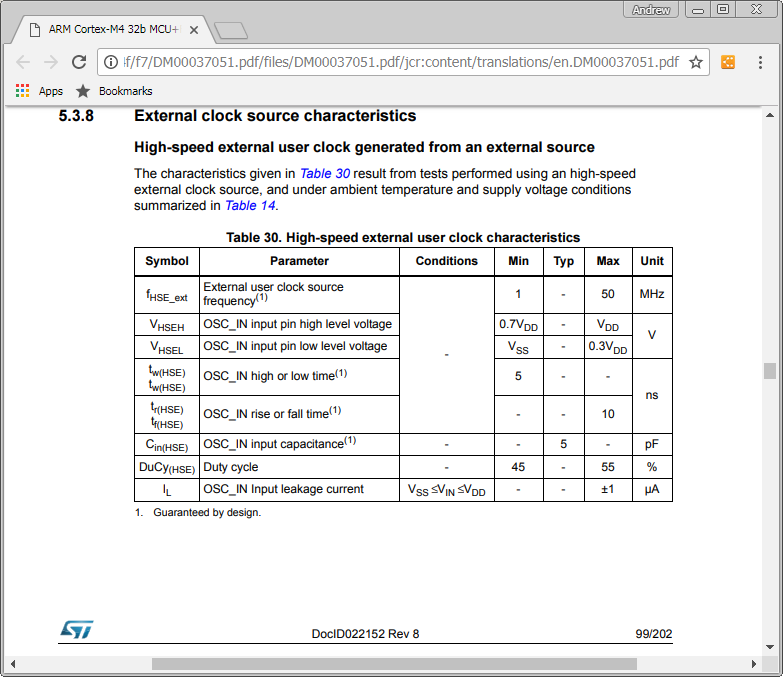

Actually 50MHz is allowed - it is the max:

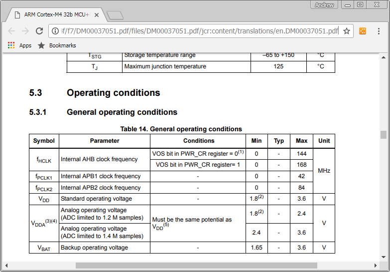

2018-03-21 6:38 AM

Yes, AvaTar, that's what tripped me up as well. Also, the Clock Configuration tool does not allow 50 MHz.
2018-03-21 7:15 AM

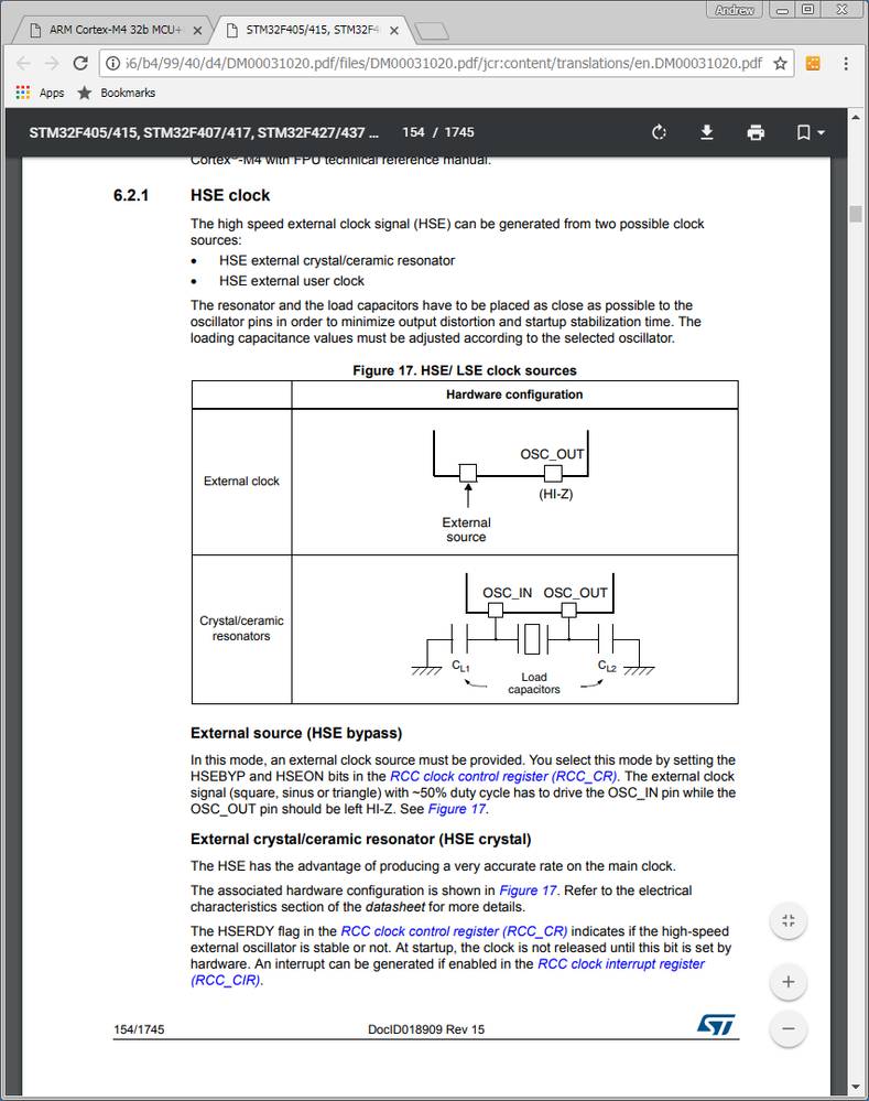

Thank you, Andrew, for the reply. The datasheet, DM00037051.pdf, mentions the 50 MHz OSC in Figure 98, but doesn't really provide any more information. The reference manual, en.DM00031020.pdf, is what I was missing. However, other than the bypass, it doesn't provide the same level of detail as the Clock Configuration tool.
Once the bypass is selected and HSE is on, how does the /2 get selected? From the block diagram, either /2 or /20 is possible. And, once this is setup, can the HSE be treated as 25MHz in order to set the other parameters? I.e. PLL_N, PLL_Q, PLL_M, etc?

ST - like many (most?) others - split the description of their products across two documents:
