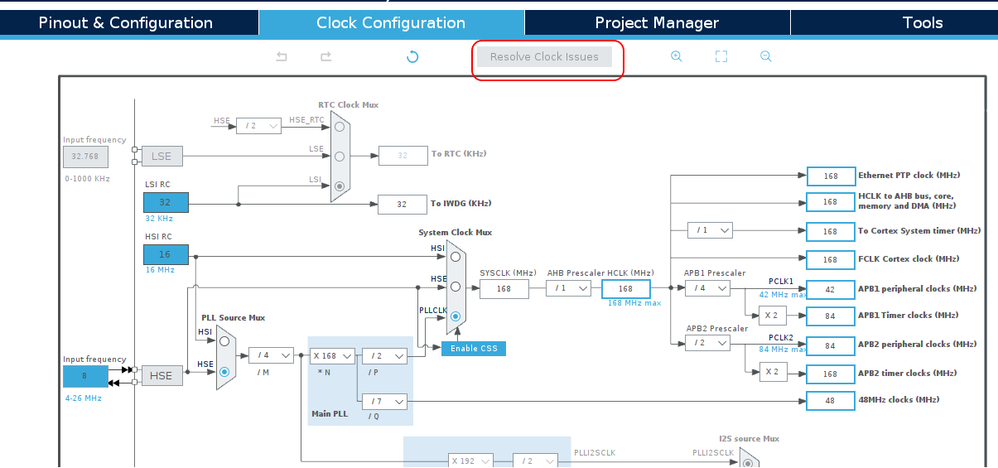

It's not the first time I've seen someone saying they're trying to use less than 40MHz on the F4. Could it be that users are not using the Clock Configuration tab of the IDE, more precisely the "Resolve Clock Issues" button?
