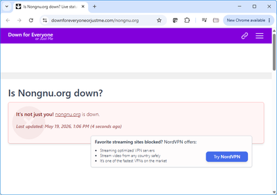

Those seem to be a problem with the nongnu.org domain - try again later ...
But https://savannah.nongnu.org/projects/lwip seems OK ...

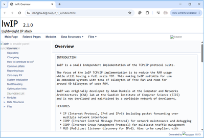

@Midhul_Pk it seems to have recovered now:
