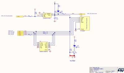

Weird, it seems a recurring issue on F407 Disco USB.
I think the issue must be linked to the hardware ! Check your solder bridges, resistors, jumpers and connector CN5! Refer to UM1472 precisely section 6.1.3 ST-LINK/V2-A VCP configuration, if you would like to use STlink to echo, you may need flying wires.

Hi @Sanyam_07
