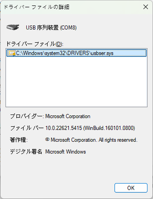

Below is a screenshot from my own PC showing the driver information in Device Manager after connecting the USB CDC device:
Also, we have confirmed that this same driver is present on my coworkers' PCs, so the issue does not appear to be caused by a missing driver.

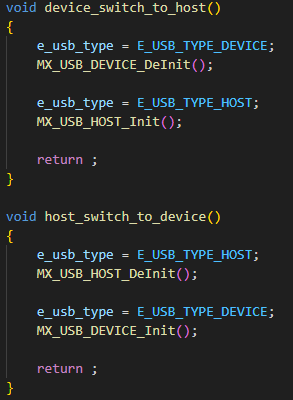

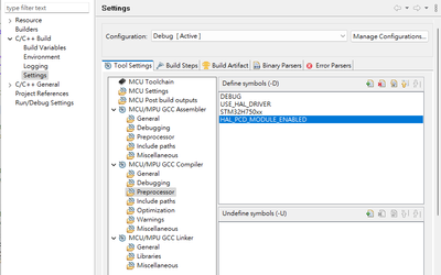

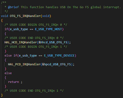

To ensure compatibility with MX, we added our code within the USER CODE sections and enabled HAL_PCD_MODULE_ENABLED via CubeIDE.
We also added two functions to switch between HOST and DEVICE modes.

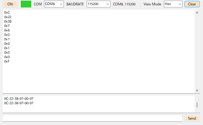

For USB CDC testing, I created a simple tool to send data over UART and verify the received data, and in my opinion, it works properly.
