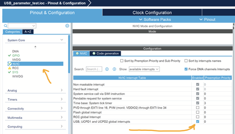

I had some issues setting up my STM32G0B1CET6N as USB Communication Device Class (Virtual Port COM).
Clock Source for the USB is the internal "HSI48 RC" oscillator, designed for USB application.
What happened?
I used the default USB Settings (default USB STMCube MX generated).
I started debugging (step by step) and came to the
MX_USB_Device_Init();
function inside the main.c
Then I open the Windows11 "Gerätemanager (Device Manger)" and the USB device always failed to get recognized.
I relaunched the debugger and this time I just klicked on the "Run" button. No step by step debugging this time. The STM32 gets recognized as a COM device without any problem.
And the communication (sending data to the putty terminal) works without any problem.
However when adding a debug breakpoint (for example in the while(1) loop) the STM32 gets no longer recognized as a COM device anymore.
Same problem as before:
So is this a bug? Or is it simply not possible to have a working STM32 COM-device when working with the debugger? Is this problem caused by the fact, that the USB works via Interrupt and interrupts fail in the debugger?
Thanks for tipps and explanations
