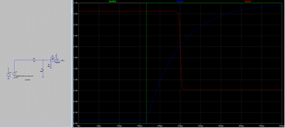

Hey. I am working on a task which requires to measure time between 2 different impulses with high precision. We have custom board that generates output pulse based on the capacitor and resistor values.
The Input is LOW to HIGH impulse (Green color on the simulation graph).
The output is HIGH to LOW impulse that is slightly delayed from Input (Red color on the simulation graph).
See the simulation graph below:

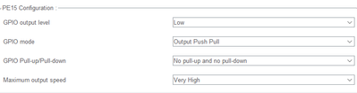

1. Configure one pin (PE15) as GPIO_OUTPUT and use this pin to generate input impulse. The pin is configured as shown below:

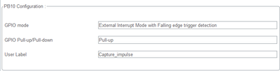

2. Configure another pin (PB10) as GPIO_EXTI and connect this pin to output signal that needs to be detected. This is configured to capture falling edge as shown below:

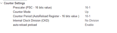

3. Use one of the general purpose timers that is configured for 1MHz to count the number of timer ticks between the GPIO Input impulse is generated and GPIO_EXTI callback is fired (falling edge of the output is detected). I have chosen TIM10 for testing purposes:
Since my APB2 timer clock frequency is 160 MHz, by selecting Prescaler as 16 and Counter period 10 I should get 1MHz timer.

htim10.Instance = TIM10;
htim10.Init.Prescaler = 160-1;
htim10.Init.CounterMode = TIM_COUNTERMODE_UP;
htim10.Init.Period = 10-1;
htim10.Init.ClockDivision = TIM_CLOCKDIVISION_DIV1;
htim10.Init.AutoReloadPreload = TIM_AUTORELOAD_PRELOAD_ENABLE;

/*Configure GPIO pin : Generate_impulse_Pin */
GPIO_InitStruct.Pin = Generate_impulse_Pin;
GPIO_InitStruct.Speed = GPIO_SPEED_FREQ_VERY_HIGH;
HAL_GPIO_Init(Generate_impulse_GPIO_Port, &GPIO_InitStruct);
/*Configure GPIO pin : Capture_impulse_Pin */
GPIO_InitStruct.Pin = Capture_impulse_Pin;
GPIO_InitStruct.Mode = GPIO_MODE_IT_FALLING;
GPIO_InitStruct.Pull = GPIO_PULLUP;
HAL_GPIO_Init(Capture_impulse_GPIO_Port, &GPIO_InitStruct);
