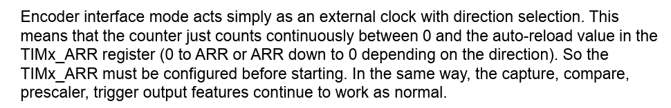

the counter have no negative values :
see rm:
So you read out timer with something wrong : maybe you read it as int ?
(signed...so compiler will show 0xFFFF as -1 . )
Read it, as it is : uint16_t , or uint32_t . Then check, what it gives you back.
