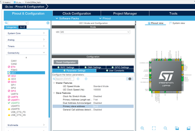

I have a new project with a STM32F407VET6 and a STM32F103xxx over a RJ45 Jack with I2C.
i worked a lot of time with I2C EEPROMs and it works fine, but my communication between the 2 STM's are horrible, or i am too confused.
i found the tutorial on https://controllerstech.com/stm32-as-i2c-slave-part-1
in this tutorial, has the Slave the Address 0x12 (without shifting <<1)
the code of the master:
/* USER CODE BEGIN 2 */
uint16_t slaveADDR = 0x12<<1;
uint8_t TxData[6] = {0x1, 0x2, 0x3, 0x4, 0x5, 0x6};
while (1)
HAL_I2C_Master_Transmit(&hi2c1, slaveADDR, TxData, 6, 1000);
HAL_Delay (1000);
okay, here are the address shifted, but my slave are not receiving data on 0x24.
my logic analyzer says, the master sends data to the address 0x24 (it's shifted.. <<1) and not to 0x12. I used the function HAL_I2C_IsDeviceReady(), but i am wondering, in the description of this function are no comments like "shifted address" or any comment..
can anyone help me, what is right for the communication?
Is my slave address 0x12 (without shifting) right? and the master communicates to 0x12<<1 (also 0x24 ?)
edit 1: in a STM32 Example on the fw lib, are the adresses 0x12F by the way....
i am confused..
Thank you! :)

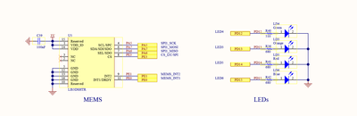

2025-09-11 6:42 AM
Hi @TDK ,
Thank you so much. I tell a bit more about my device:
- STM32F407G-DISC1
- It could function with SPI1, but couldn't work well with I2C1.
- I tried to measure frequency of SCL/PB6, but the result was incorrect ( it should be 100 KHz, but I didn't see that.)
You said "which is a hardware issue", I will verify it.
