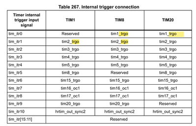

Look at the slave timer's TIMx_SMCR description, there's a table which lists which timer can be used as master to that given slave timer.
[EDIT] OK so this is one of those new-fangled RMs, where this information is not there, where it used to be in older families' RM, but hidden at the beginning of TIM chapters and in the interconnect chapter (the page you've given is in that chapter, but you want to look at the table aptly named Interconnect 1). So the answer is no, regardless of what the internets say. TRGO2 appears to be usable only to trigger ADC in 'G4.

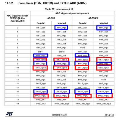

2025-09-11 5:55 AM
The ITRx signals are hooked up to TRGO, not TRGO2, so it can't be used to trigger slave timers.
Search "TRGO2" in the reference manual and you'll see it's mostly used for triggering the ADCs.

The RM says what is possible. It can't say everything that is not possible.
It says TRGO is used to trigger slave timers and that TRGO2 is used to trigger the ADC. Those are both true.

@waclawek.jan wrote:....
Thank you very much for taking the time to make color notes in this table. The most valuable thing for any person is his time and if he spends part of his time on someone else, it means he shares a small part of his most valuable. I will continue to study. All the best.
