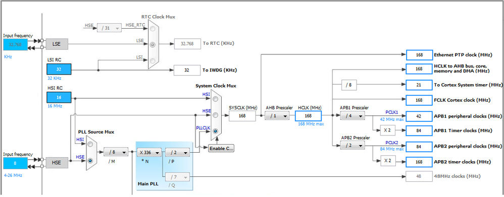

I have started a new project. I need to set 3xSPI at max speed. I'm using the discovery board with a STM32F407VGT6. This board has a 8mhz christal. I'm using cube, it is a nice tool that i'm starting to use with this project. I have configured the clocking setting in cube for this board to get the max speed possible in theory (check attached image and code)void SystemClock_Config(void)

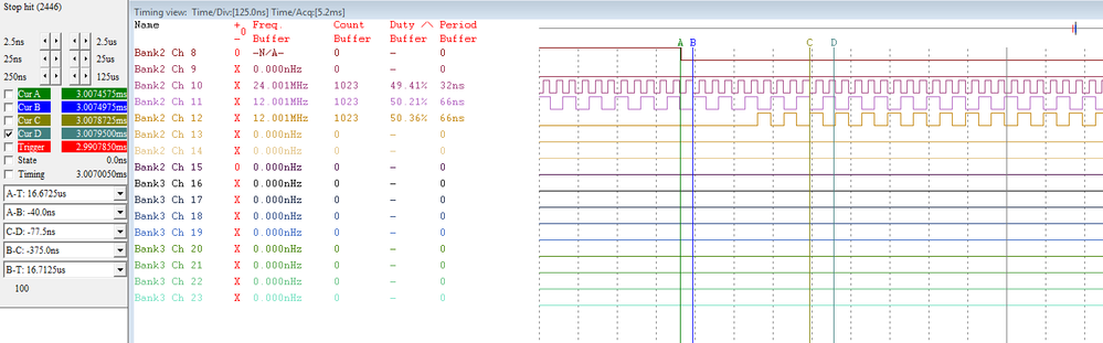

as result I get :
2015-05-04 3:42 AM
2015-05-06 1:01 AM
Any tip on this?. I have been searching with no luck. Spis are half of the max theorical speed, and only rising the apb1/apb2 to 2x the max speed I get the 42mbits/21mbits.
EDITED: Strange, I didnt change anything in clocking, or spis, just continued with other stuff (nothing with spis) but it is working now and i dont know why.... I would think that it is a cube bug but initialization was ok and it is the same that i have actually ...,We’re moving the ST Community to a new platform to give you a better and more reliable community experience.
