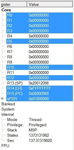

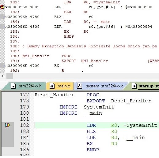

This is the exact moment of the reset_handler:
