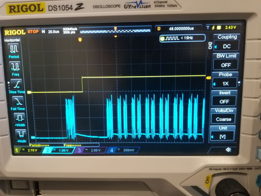

edits: I used the transmit callback routine to trigger my oscilloscope to catch the rx/tx line data. See attached screenshot. As you can see data packets do occur although these could be the NAKs.
