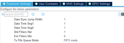

2024-08-19 3:22 AM
Thank you for your help. I have found the issue. I had filter definition but in the .ioc file my Std Filter Nbr was set to 0 since I forgot to set it. It works fine now!

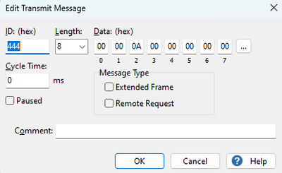

2024-08-19 2:50 AM
since I am using TouchGFX i figured it seems appropriate.
I was calling it in the task and in the callback because I wanted to test it since it never gets to the callback because interrupt doesnt trigger. I have later removed it from the task and left it only in the callback.
Clock source selection: TIM6 with HSE crystal/ceramic resonator

The message Im trying to send to trigger the interrupt looks like this:
The filter seems to be correct and data is being sent to the PCAN-View so I know that hardware communication is fine
