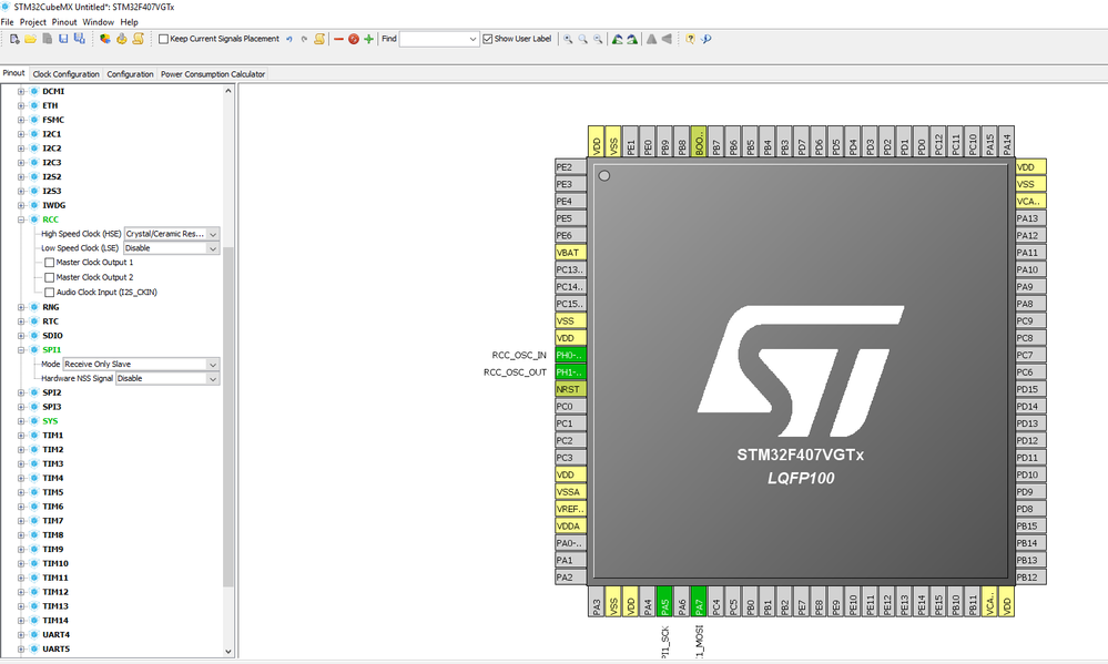

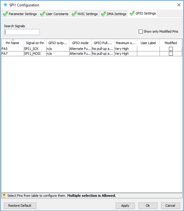

And there is the speed of the clock, as you can see its around 1.5us each clock pulse. So what i have to do is configure spi with HAL, i toolk SPI1(PA5 - CLOCK, PA7- DATA) cuz it has more powerful MHZ, chose spi mode ''RECEIVE ONLY SLAVE'', HARDWARE NSS SIGNAL: DISABLED. And here is my spi1 config:

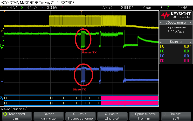

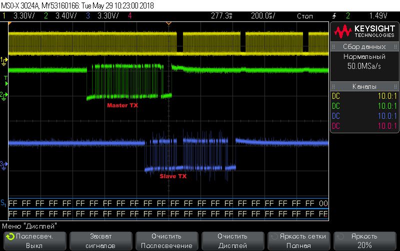

Im sending from slave the bytes which i get from master, in purpose of debugging, and the data is same, so its perfectly synchronized and seems like slave reading all data master sends. Here is the images:
1) Slave is my STM32f4 and master that i catching, its the same
2)Zoomed up
The problem is that i dont know how to read that data, its 16bytes which i need somehow to read without slowing the spi down. All my attempts to do that are failed. The whole code are:

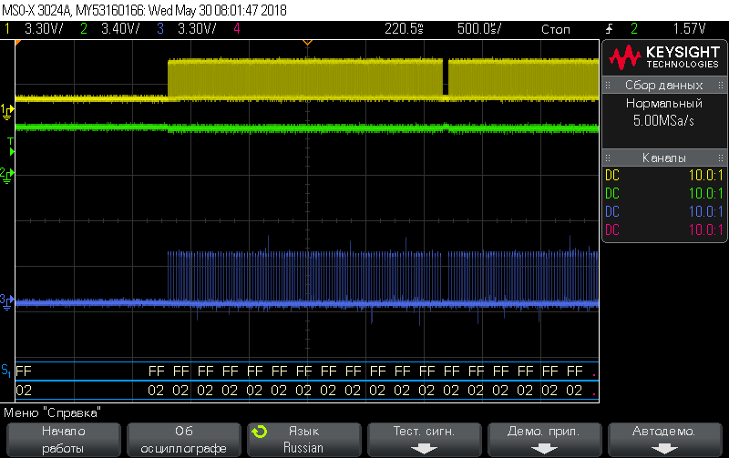

Okay, the HAL_SPI_TransmitReceive is really strange for me. for exmaple if i use HAL_SPI_TransmitReceive(&hspi1, (uint8_t*)spi_Txbuffer, (uint8_t *)spi_Rxbuffer, 16, 2000);
outside of while(1) it should read 16bytes from master when it get first clocks and send 16bytes to master, this is how i see it. But what excatly i got
I used diffrent buffers as T J suggested, so tx_buffer sending 02 on every clock, why does it happening if i inisialize get and send 16bytes only once.

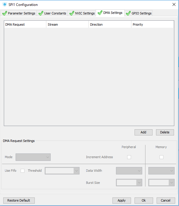

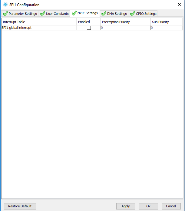

Yes Cube, i keep it simple: no dma no interrupts

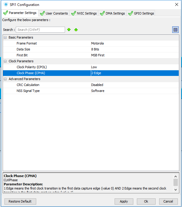

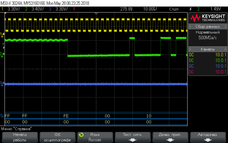

I chose CPOL low and CPHA 1 edge, because seems like master works in MODE 1, here is FE0010 data:
