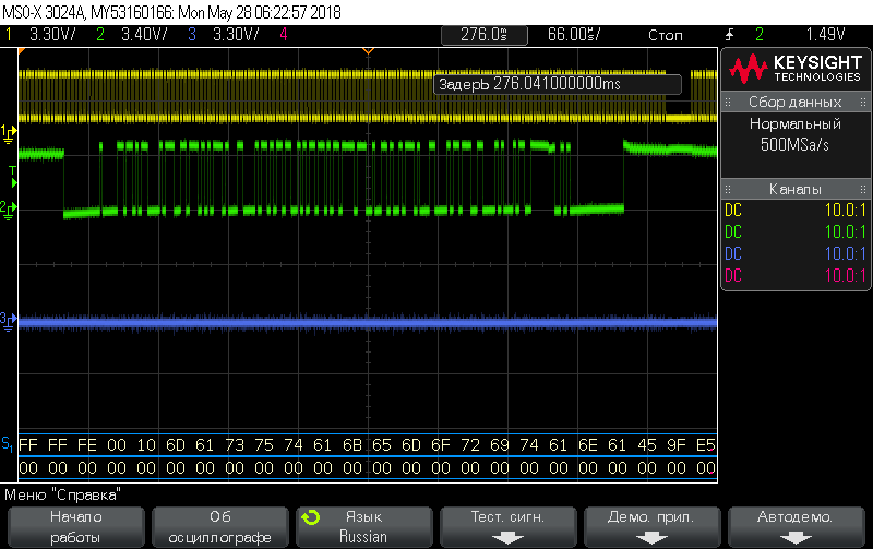

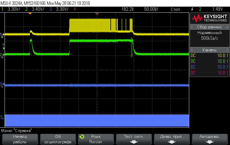

Im trying to catch data from the unknown device, this device has data and clock. I decided to make my stm32 as spi slave and catch the data as recevier.And im struggling with it. I have this data flow which i want to catch:
Clock is yellow and green is data.

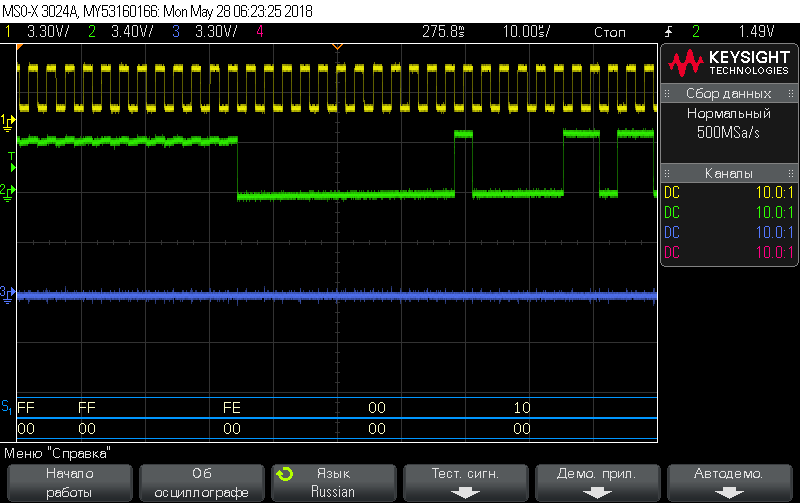

I need only 16bytes from it, when data line goes low, we can see this 16bytes:
And there is the speed of the clock, as you can see its around 1.5us each clock pulse. So what i have to do is configure spi with HAL, i toolk SPI1(PA5 - CLOCK, PA7- DATA) cuz it has more powerful MHZ, chose spi mode ''RECEIVE ONLY SLAVE'', HARDWARE NSS SIGNAL: DISABLED. And here is my spi1 config:
