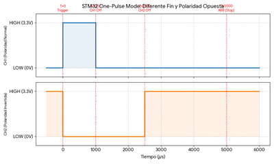

Description: I am attempting to generate two simultaneous pulses of different lengths using a single timer (TIM4) and multiple channels.
Current Implementation: I am currently using One-Pulse Mode (OPM). In my existing setup, the pulse starts at CCR and ends at ARR. However, since ARR is a global register for the timer, all channels are constrained to the same end time, making it impossible to achieve independent pulse widths if they all trigger at the same ARR event.
Objective: To achieve independent pulse widths, I want the pulse to start at CNT = 0 and end at CNT = CCRx for each channel. This would allow CCR1 and CCR2 to define the lengths independently while sharing the same timer base.

Questions:
Is switching from FORCED_INACTIVE to PWM1 the standard approach for starting a pulse at T=0, or is there a more robust configuration using PWM2 and inverted polarity?
Why is a small CCR value (e.g., 2 ticks) not resulting in the expected output width when using this state-switching method?
Is there a better way to achieve independent pulse lengths on multiple channels of the same timer using OPM?

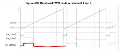

2026-01-28 11:30 AM - edited 2026-01-28 11:31 AM
Have the pulses start on tick 1 instead of tick 0. Set up CH1 and CH3 in combined PWM mode 2, others in PWM mode 1.
CCR1 = 1
CCR2 sets top pulse
CCR3 = 1
CCR4 sets bottom pulse
Reverse polarity of the bottom pulse.
