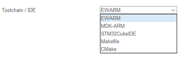

Hello @Mario Luzeiro
To clarify, which of those options did you choose for code generation?
THX
Ghofrane
2026-02-03 7:21 AM
@Ghofrane GSOURI CMAKE
