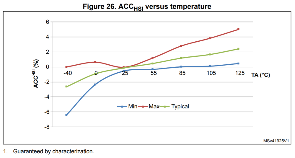

Hi, I am using STM32F401CCU6 on my circuit and it working well at room temperature. When I was testing the circuit in low-temperature below -10 degrees the RX of UART1 lost messages, when I came back to 0 degrees the circuit is coming back to normal opera
2021-01-03 3:40 AM
If you are using internal RC oscillator (HSI) as system clock, then this is normal, the oscillator is temperature dependent. See datasheet.
You may try to mitigate it by recalibrating the HSI on the go, or simply using HSE with a crystal.

> who can I do this recalibrating for low temperature?
You can recalibrate using the HSITRIM bits in the RCC->CR register and you can poll for the internal temperature using the internal temperature sensor. The tolerance range for HSI is quite large.

I saw a similar problem placing outdoor units in Canada and Russia during winter, using an STM32L0 part.
Short answer is you have to continually recalibrate the HSI when used in extended temperature regions (you'll see the problem in deserts during summer too). As a prior post pointed out, you can create a table, but this requires testing EVERY SINGLE UNIT in an environmental chamber over the full temperature range (-40c to +50c). This takes considerable time to set up and run. And it likely still won't work because the HSI is also sensitive to humidity. So -20c with blowing snow or freezing fog is substantially different from -20c on a nice sunny day.
The other alternative is to use a known good time source to calibrate the HSI at intervals. I used the die temperature in the STM32 to run calibration after a fixed number of degrees changed. If you don't have an HSE then you will need an LSE with external crystal (i.e. the RTC clock) and a low PPM over an extended range. Most STM32s have a method to internally clock a TIM timer with the SYSCLK (HSI) while triggering timer captures with the LSE. The pulse widths can be used to determine actual HSI frequency and calculate a new calibration factor.
If you don't have an LSE or any type of crystal or TXCO clock source then you have a serious design flaw in your PCB. Without a reference there is no way to solve your problem unless you use something other than a UART for communications (which doesn't rely on a fixed clock rate).
