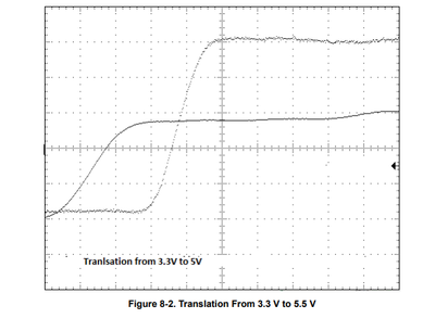

Ok, so for 3v3 -> 5V level , can use AHCT types, like: 595-SN74AHCT1G86DCKR (mouser, 20ct );
at VDD 5V , for this gate of course . (I use it also for this 3v3 -> 5V conversion at hi speed.)
at 2ns/div:

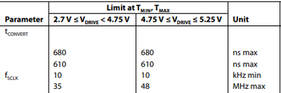

I used the ADC is AD7366[1].
If I want to use a higher SPI frequency, I need to provide Vdrive 5V, but the MCU output high is 3.3V, which is less than 0.7 * 5V ADC input high voltage.
[1] AD7366 datasheet
2024-04-23 6:55 PM - edited 2024-04-23 6:55 PM
Looking at the ADC’s datasheet page 4, VINH min = 0.7 x Vdrive = 3.5V > VDD MCU. So indeed you need to adapt the voltage of the IO externally in the direction from STM32 to the ADC.

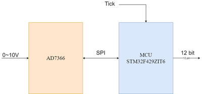

This is my current architecture:

The processing time include
1. Tick MCU
2. MCU to ADC check
3. ADC convert
4. SPI serial read time
5. MCU output 12bit ADC data

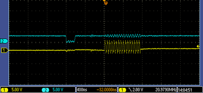

This is the time it currently takes for the MCU to obtain ADC 12-bit information:
Blue is CNVST, Yellow is SCK
So, SPI transfer time only the part of processing time.
To improve the overall application performance, can you start processing the early data before the transfer has completed?
I plan to experiment with various methods to reduce processing time.
