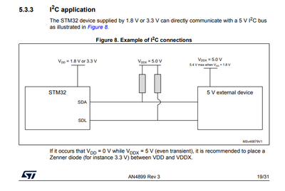

Hello @Scarlet ,
It's possible to setup the configuration described and speaking about 5V tolerant pins only in input mode.
When the output mode is enabled, the GPIO is no more 5V tolerant.
It could work based on next principle for I2C. Taking into consideration that problematic could be difference between VDD and VDDx, which should never exceed 3.6 V:

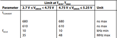

Because this ADC can use a higher SPI frequency with a Vdrive of 5V, I want to try if it's possible to reduce processing time.

Hi @Imen.D,
Originally, I planned to use the Open Drain method to provide external 5V, but in CubeIDE, the SPI setting is configured as Push Pull. I cannot guarantee that when outputting a high level, the 5V won't flow to the STM32 VDD 3.3V.

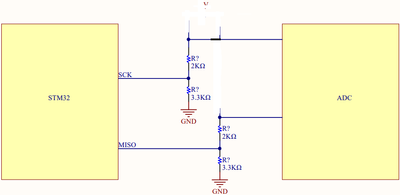

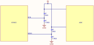

The voltage divider is like this?:
2024-04-22 11:36 PM - edited 2024-04-23 2:06 AM
>The voltage divider is like this?: yes, but without the short to 5V . :)
But need lower impedance resistors, at 2k /3k3 it might work up to 10MHz - but never 50MHz.

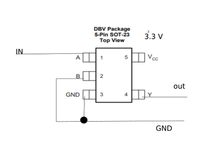

as level shifter gates i use something like this :
SN74LVC1G86 (single XOR gate ; at mouser 20ct , 595-SN74LVC1G86DCKR )
so need one for every line :
At 50MHz this is the way to go ; LVC gate can switch in 1.3ns at 3v3 (50pF load), so perfect here.
