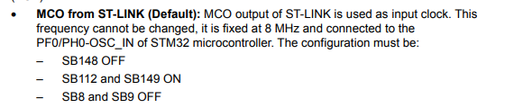

I'm currently using the NUCLEO-F429ZI development board. I'm planning to create a PCB using the STM32F429ZIT6, but I've encountered some questions during the planning stage.

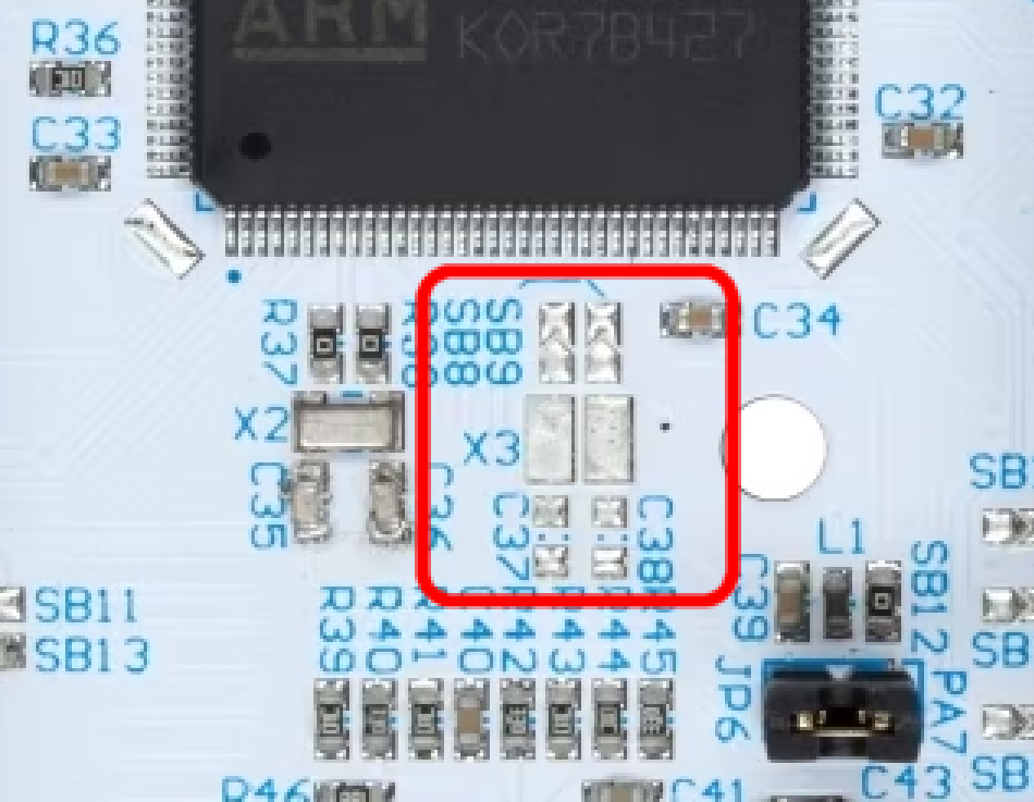

Yes, X3 is the HSE OSC.
Although I'm not entirely sure about the meaning of 'not provided,' I should be able to design with HSE 8MHz.

@Scarlet wrote:Yes, X3 is the HSE OSC.
No, it's not the oscillator; it's just the crystal - ie, the resonant element for the oscillator.
@Scarlet wrote:Although I'm not entirely sure about the meaning of 'not provided,
It means it isn't fitted to the board:
@Scarlet wrote:I should be able to design with HSE 8MHz.
With X3 not fitted, you won't be using HSE at all - you'll be bypassing it, and using the 8MHz clock signal from the ST-Link.

The default for the board is to bypass the HSE, and use the 8MHz clock signal provided by the ST-Link

My current understanding is that there is no X3 OSC on the development board, and the 8MHz is currently provided by the STLink. Right!?
2024-04-17 7:28 PM
Yes. By default X3 is not populated, for external clock source STLink MCO is an alternative.

@Scarlet wrote:My current understanding is that there is no X3 OSC on the development board, and the 8MHz is currently provided by the STLink. Right!?
Again, X3 is just a crystal - it's not an oscillator:
