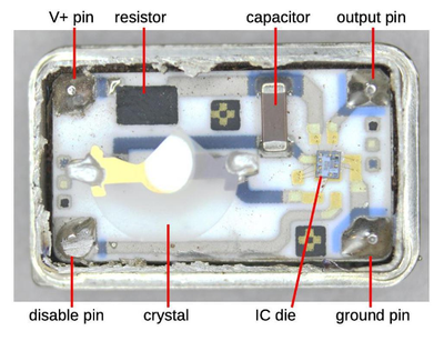

But here is a description of what's inside a Crystal Oscillator:
https://www.avrfreaks.net/s/topic/a5C3l000000UcE1EAK/t160729
As you can see, an oscillator is a complete active electronic circuit:
It contains a crystal plus all the active circuitry necessary to make it oscillate and give a nice, clean digital clock signal as output.
The crystal itself is just a passive component:
it requires extra active electronic circuitry to make it oscillate.
In the case of a microcontroller, the oscillator circuitry is usually inside the microcontroller chip (eg, the HSE within the STM32) - so you just need to provide the crystal externally.
Update:
From an article from SiTime describing the difference between a crystal oscillator (XO) and just a crystal (XTAL):
#CrystalVsOscillator #OscillatorVsCrystal

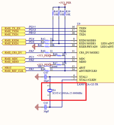

Sure that's not driving the Ethernet PHY?
I might check the schematic later.
Check the EVAL or DISCO boards, the might use a 25 MHz clock.

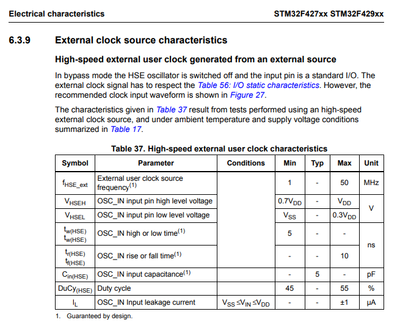

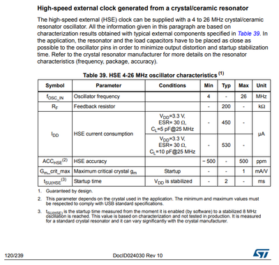

2024-04-17 5:29 AM - edited 2024-04-17 5:51 AM
@Scarlet wrote:
- According to the datasheet, HSE_OSC is specified to provide 8MHz, ?
That'll be when it's used as an oscillator - with an external crystal.
@Scarlet wrote:
- However, on the NUCLEO-F429ZI development board, the JFVNY 25.000 oscillator supplies 25MHz?
There you're using an external oscillator, and just feeding a clock signal into the chip - bypassing the chip's own HSE oscillator.
EDIT:

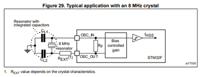

The datasheet actually says that the HSE Oscillator can do 4-26 MHz:
With an external oscillator - ie, bypassing HSE - the clock input can be 1-50 MHz:

As stated by @Andrew Neil the datasheet indicates that HSE could be in the range of 4-26MHz.

According to the schematics there is no even the crystal PCB footprint on the board of the HSE. Could you please tell us which from which reference you did conclude this information. Could it be X3 (the crystal used for the ethernet PHY?

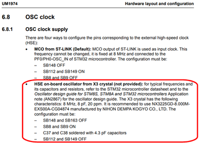

2024-04-17 7:01 AM
I think I misunderstood. In the UM1974 User Manual, it states that "JFVNY 25.000" is the X4 oscillator. Although it doesn't specify what part of the oscillation it provides, the document indicates that X3 is the HSE oscillator.
2024-04-17 7:11 AM
Yes, I saw in the datasheet that it states "the HSE Oscillator can do 4-26 MHz."
To avoid affecting other timing, I'll start with setting the input HSE to 8MHz as indicated in the IDE. I'll further study the external oscillator section.

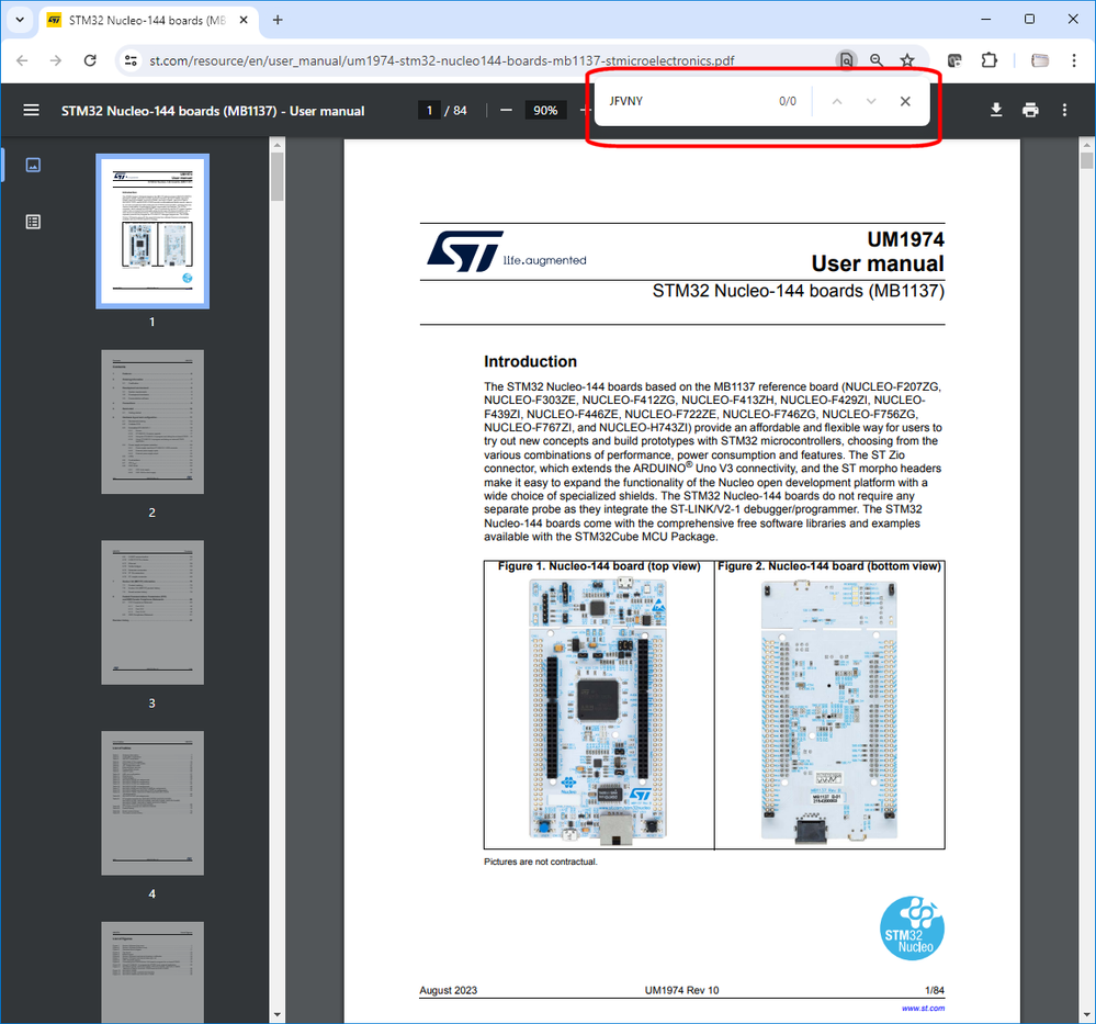

2024-04-17 7:20 AM - edited 2024-04-17 7:28 AM
@Scarlet wrote:In the UM1974 User Manual, it states that "JFVNY 25.000" is the X4 oscillator.
Does it?
I don't see "JFVNY" mentioned anywhere in that document:
I also don't see "X4" anywhere.
That's Rev 10 (Aug 2023) - What revisions of board & manual do you have?
2024-04-17 7:24 AM

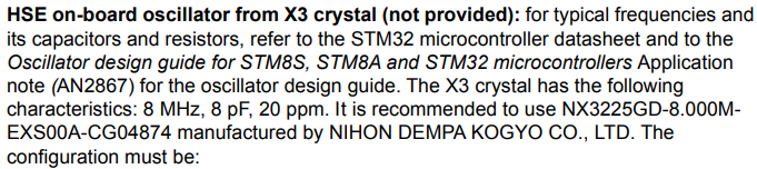

@Scarlet wrote:Although it doesn't specify what part of the oscillation it provides, the document indicates that X3 is the HSE oscillator.
It tells you that X3 is (or would be - it's not fitted) the crystal for the HSE oscillator:
Yes, I mistook X4 for the HSE OSC. I found in the UM1974 User Manual that X3 is the HSE OSC. However, I'm still unclear about the meaning of 'not provided'.
