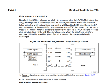

The STM H5 manual says, SS pin is optional for single master and single slave.
2024-04-19 12:28 AM - edited 2024-04-19 1:54 AM
But it is how you'd synchronise the Slave to the Master - if you choose to omit it, then you have to devise some other sync scheme.
The fundamental issue with omitting NSS is, exactly, that you lose this synchronisation!
